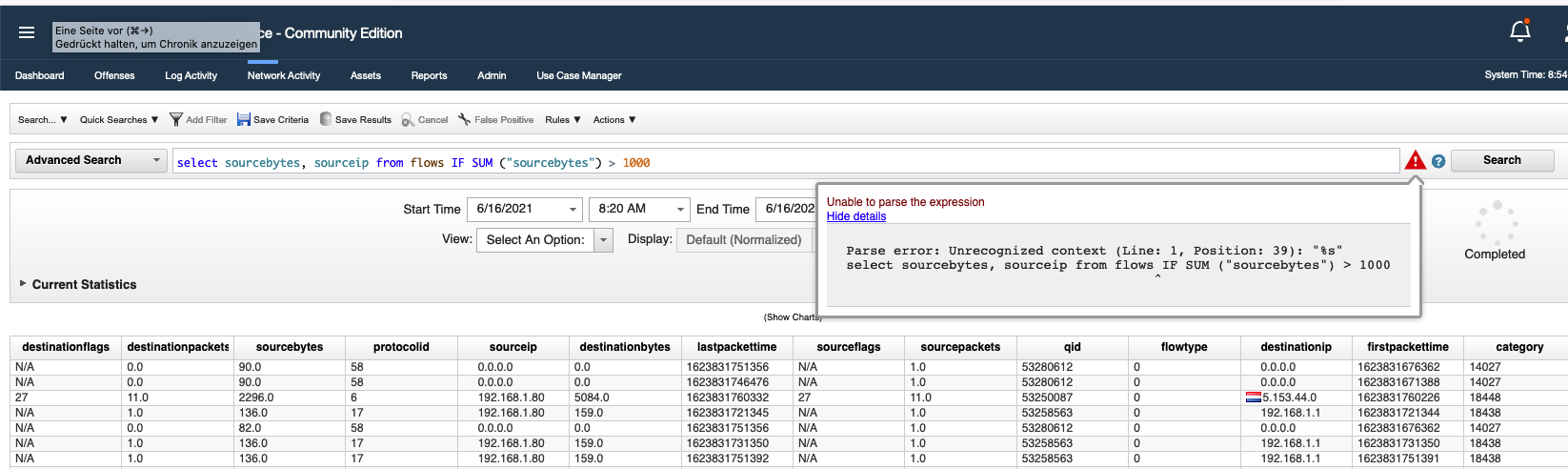

    Please use type ahead function in AQL to see what is allowed in your specific release environment. That is part of our QA process as QRadar consultants. If not you receive strange parse errors as shown. If your context usage is correct it will work for you as shown in my sample, which BTW is a demo search for your use case. Unfortunately I have no historic flow usecase available using SUM and flows. Tested on 7.3.3 and 7.4.3. Unfortunately there is no guarantee that AQL functions used in customer use cases will work forever :-)

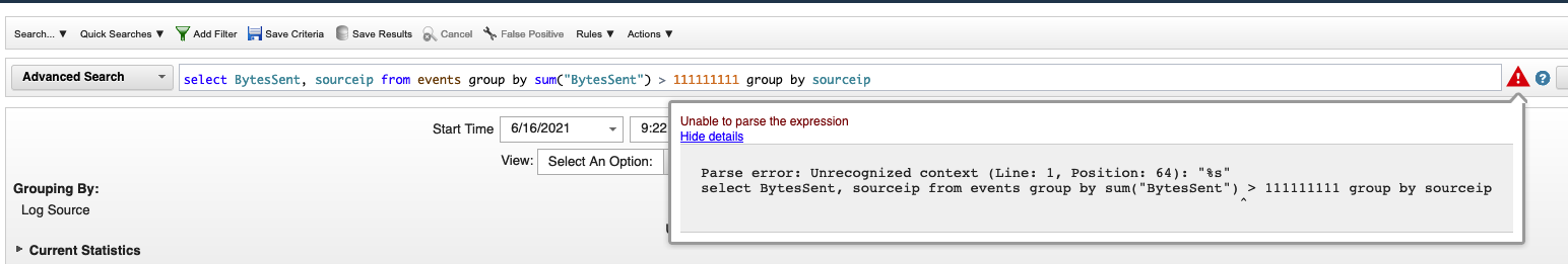

    as outlined before: best practice and test reference is AQL search. Your search does not work. Thats bad. Log activity AQL search using "select BytesSent, sourceip from events group by sum("BytesSent") > 111111111 group by sourceip" fails as shown below. Not sure what you are trying to achieve but your assumptions are wrong. See screenshot below. Our best practice is AQL search first than rule test.
