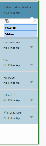

    I'm not sure which version you are, for me in r12 this seems to work. Once the OOB report is checked out, you click on the global filter and then on the left hand side, the compact Slicer Configuration panel will display, either right click and add current slicers to the filter or find another field to filter by.
    (right click)
    After photo:
    If this doesn't help, send me which report you are working on and I can take a stab at it.
    -Daniel

    Hi Susmitha morisetti, typically when a report is checked out the report elements will have a yellow or green boarder, can you confirm the report is checked out? I didn't see that it was in the snap shot. If it is, you may need to refresh your browser and try again. See an example of the filter up above with the green boarder when checked out.
    I'm not aware of any permissions with OOTB Reports either so this seems odd unless it is something new and I haven't come across it yet. We do not have the latest Version r12.4.0486b13b4e4b.74069 release, so my reports don't look like the reference project. In the link below it talks about both compact slicers, local and global. Currently I only see Compact slicers.. neither are distinguished. Maybe Apptio Support can help? You may want to put in a ticket with them.

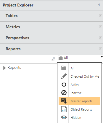

    Susmitha morisetti Which report are you looking at? Depending on the report, the filter might've been created in a Master Report (which you can find under the Report section of TBM Studio and changing the view to "Master Reports"). And as with all customizations of OOTB reports, be sure you document the changes so you can re-create them (if needed) after upgrades.

    Susmitha morisetti Which OOTB report are you looking at and which filter are you looking to move/resize? What I'm suggesting, is that this report might be built of a "Master Report" (think of it like a template), which is where the filter would be configured (and not the report itself). You can see these Master Reports by changing your view in the Report section of Project Explorer from "All" to "Master Reports".
