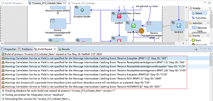

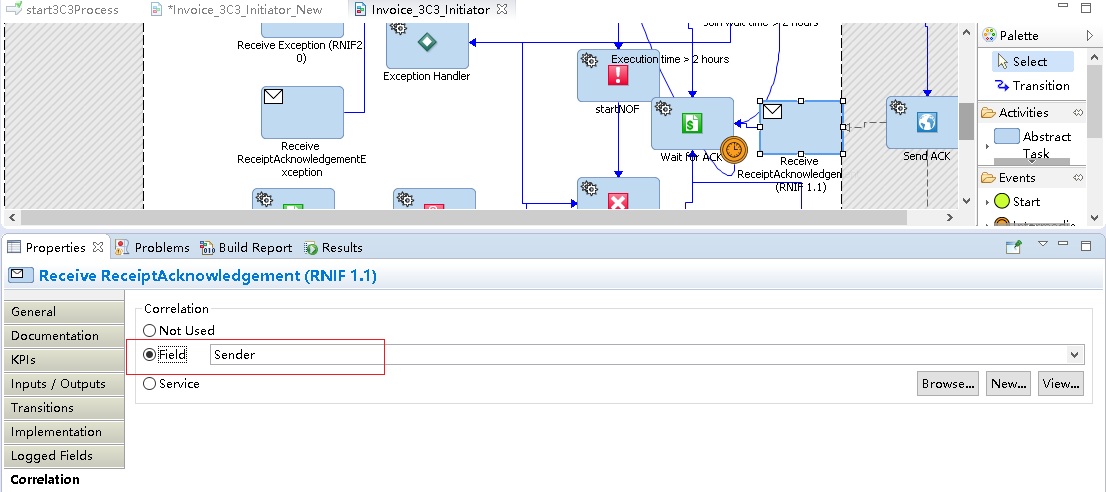

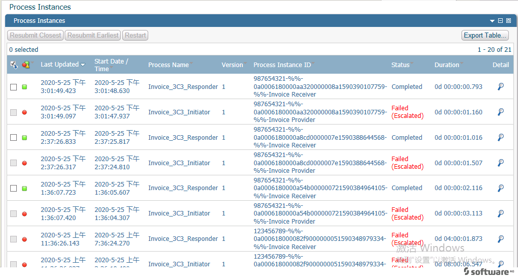

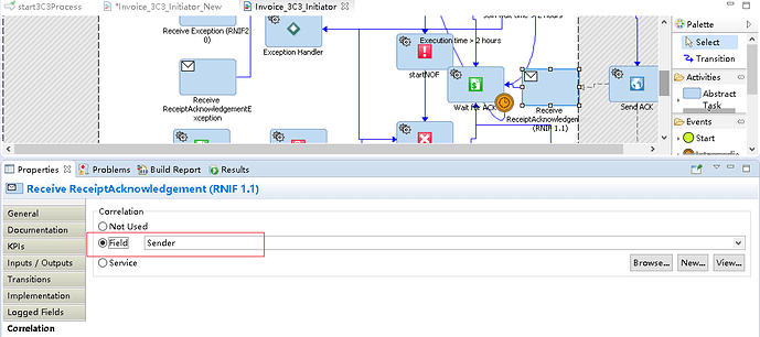

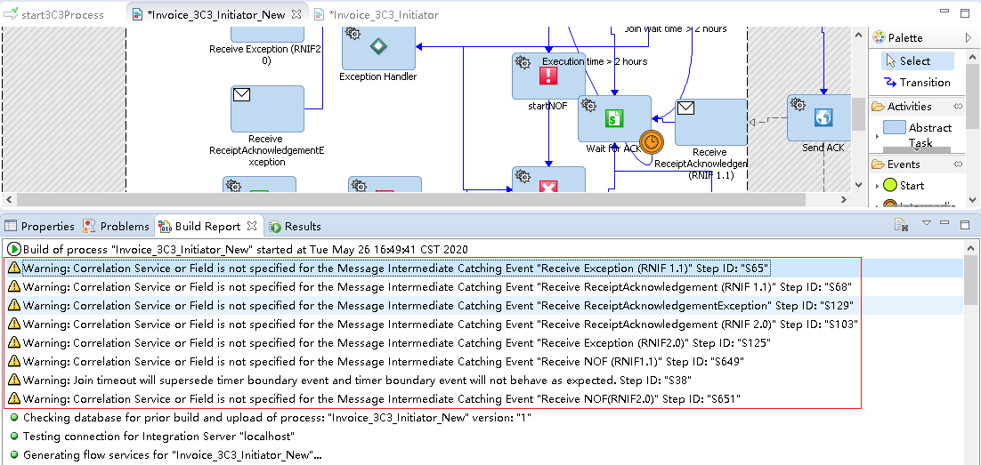

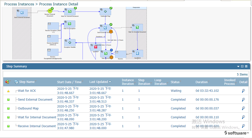

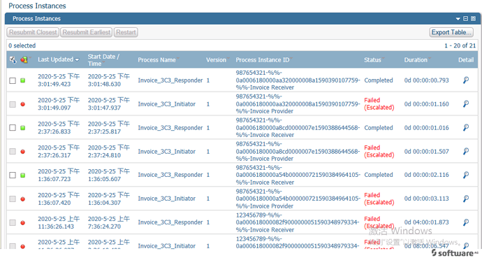

After triggering a 3C3 conversation, on MWS Process Instances tag, the initiator's side has been waiting for the fulfiller's ACK and is finally failed with below exception:
“[530]2020-05-25 15:01:49 CST [ISU.0000.9999I] Estd_1590390109028;Proxy=Estd_1590390109028:com.wm.estd.common.log.EstdLog.log:123: Cannot execute the asynchronous request Reason:com.wm.estd.rosettaNet.RosettaNetException: com.wm.app.b2b.server.ServiceException:[PRT.0101.9306] Correlation field Sender does not exist in published document ReceiptAck--------------”.

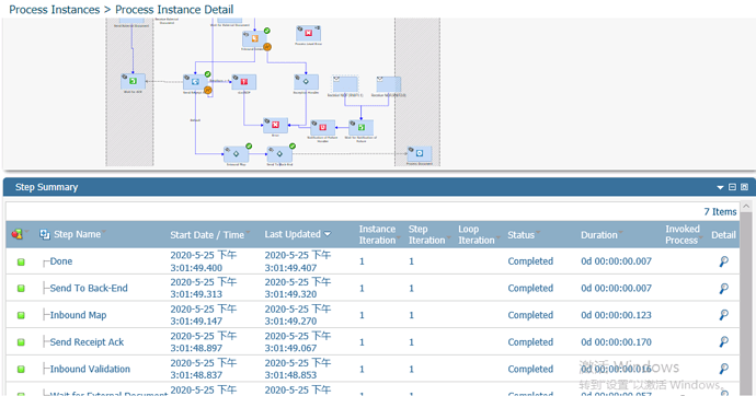

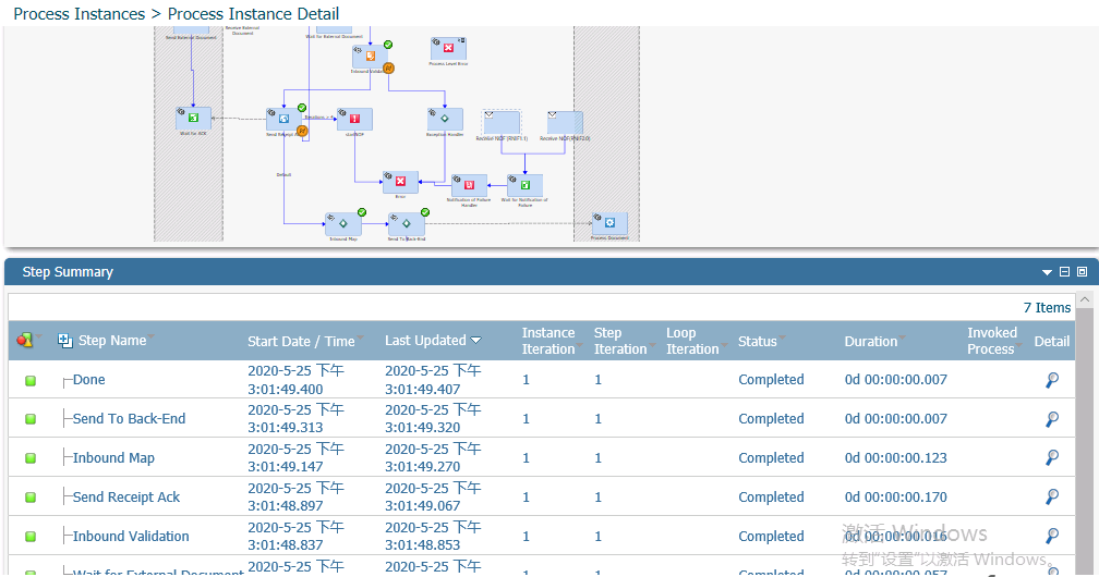

On the fulfiller side, the state of 3C3 conversation is completed and ACK has been sent back to initiator's side successfully.

I have attached screenshots of the exception, Please advise how can I resolve the problem, thanks.
