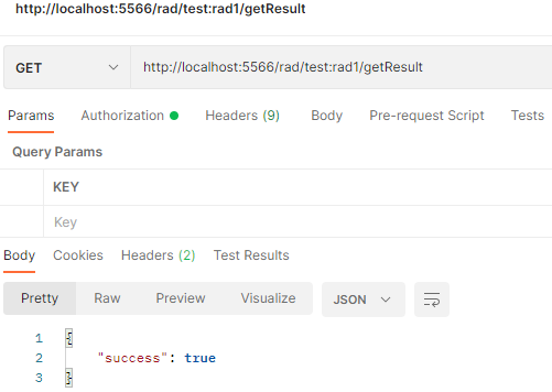

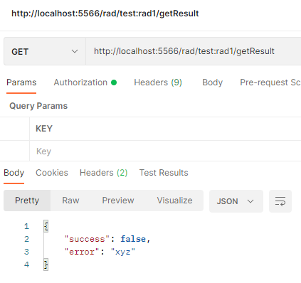

  • 3.  RE: restV2 rest end point response
    Posted Mon April 04, 2022 04:44 AM
    Should be something like this
    true case
    false case
