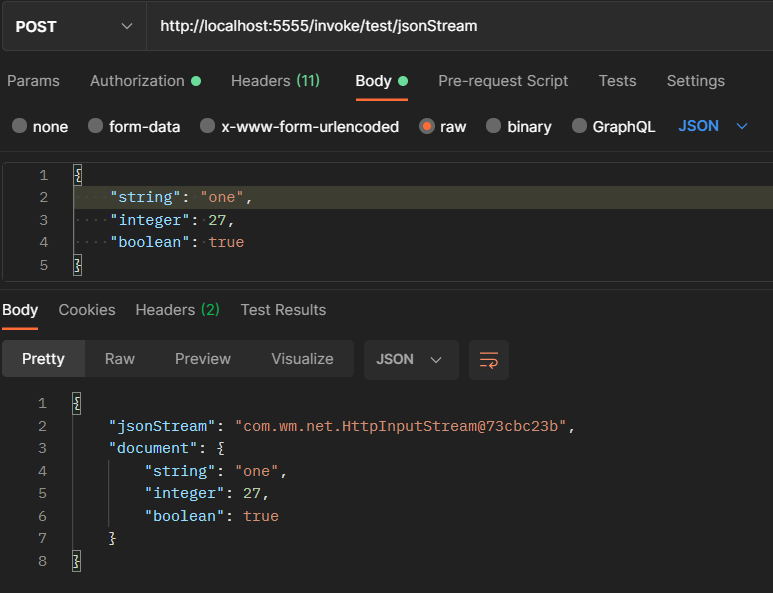

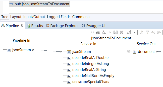

    Hi. I’m not able to reproduce this in IS 10.7. My service looks like this:
    And my request/response looks like this:
    What version and patch level are you using?
