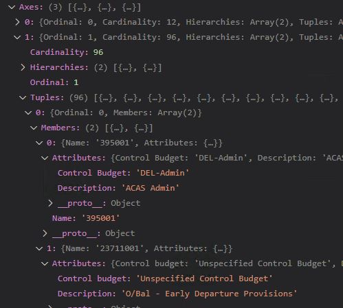

    The Attributes are under Axes\Tuples\Members\Attributes. Using the \ and comma I get just the 2 attributes that I selected
    Tuple to Member showing only 2 Attributes selected
