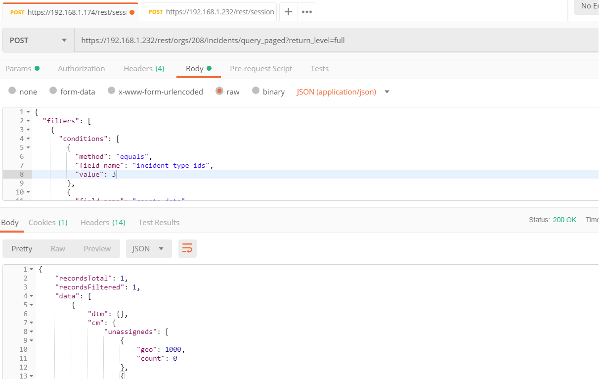

    Can you try to add "return_level=normal"  or "return_level=full" in your API, such as:
    https://resilient-url/rest/orgs/201/incidents/query_paged?return_level=full
    LILY WANG

  • 7.  RE: Resilient REST API
    Posted Tue May 14, 2019 02:58 AM
    I don't see any error using Postman in the same way. For "internal server error", you may check server side client.log for details.

  • 8.  RE: Resilient REST API
    Posted Tue May 14, 2019 09:01 AM
    Edited by Juan Cruz Del Col Tue May 14, 2019 10:00 AM
    Lily, my apologies ... I was using GET and it should be POST.
    It works perfect!
