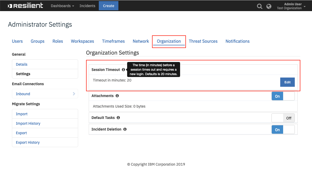

    Hi Shane,
    How we increase the timeout time?
    Best
    Jasmine
  • 5.  RE: Resilient Authentication
    Posted 12/10/19 07:32 AM
    Hi Jasmine,
    If you would like to increase the timeout for Resilient's UI, you can do so under Organization Settings:
    a

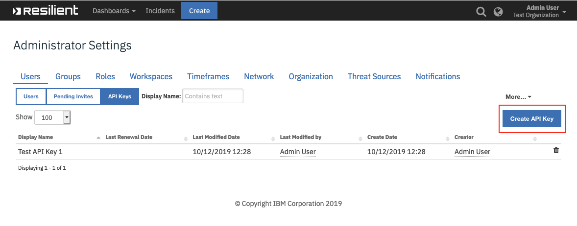

    If you are writing an Integration with Resilient, we now recommend you migrate to using API Keys to authenciate your Integration with Resilient as an API Key will not timeout.
    You can create a new API Key by heading to: Administrator Settings > Users > API Keys > Create API Key
    b
