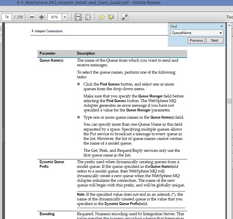

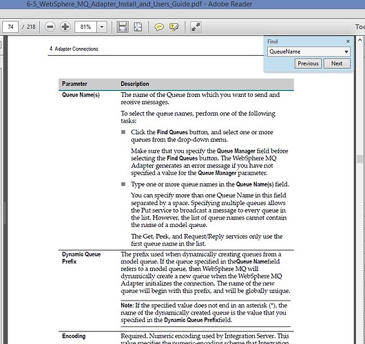

  • 4.  RE: Request Reply adapter service
    Posted Mon June 27, 2016 04:25 PM
    Hi Vishwadeep,
    Thank you for your information.
    I also have gone through this document but tested this scenario. But unfortunately it is not working.
    I have provided ‘MQ1 MQ2’ in Queue name field and also using debug log traced that MQname. My observation is it is fetching only the first queue.
    Testing is getting failed with error message ‘Error Log : [ISS.0086.9091] Parameters xmldata, $filestream and $filedata are all missing. One of these must not be null.’
