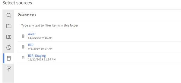

  • 11.  RE: Reporting on SQL Data that is not in a Framework Manager Package
    Posted Thu February 04, 2021 09:06 AM
    Sure thing Brenda, let's see if this image comes through:
    I glanced at other server connections (most of mine are mysql, not ms sql) and they all have that driver class name field below and I never edit it manually. Not sure why it's not listed on yours? Though I'm on 11.1.4
