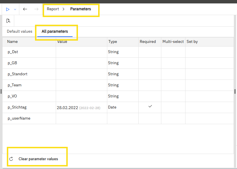

    I think you are looking for the 'Clear parameter values' option.
    This can be found on the Report properties page within the report editor, as shown in the screenshot below:
    (screenshot shows a blank report so the parameters box is empty)
