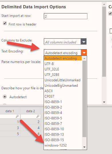

    Hi all.  I saw this thread, and we have seen this in the Apptio delivery team many times.  It has to do with text encoding, sometimes it is UTF-8 or Unicode, which are pretty standard encodings.  But sometimes text is imported with a more obscure encoding.  There are a couple things you can do.
    1) If you are importing a delimited file (like a .csv, or .txt, or a .zip with a CSV inside), Apptio allows you to choose different encodings!  I find if you are getting odd characters, try some of the other encodings; particularly the "windows-1252" or "Windows-1257" and see if those characters disappear or are displayed correctly.

    Posted 12/23/19 11:22 AM
    I ended up changing my text encoding to windows-1252 and the character disappeared.
