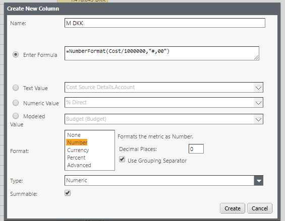

  • 2.  Re: Removing notations
    Posted 09/28/18 09:08 AM
    Hi Jesper
    You should be able to add a new column and specify the format of it.
    Create New Column
    It will look like below in a table
    Result in table
    Result in graph
    Result in Graph
    In this graph, I've hidden X and Y axes and included data in the graph.

  • 4.  Re: Removing notations
    Posted 09/30/18 05:35 PM
    Hi Jesper,
    Select the existing chart , and in the report tab, you can select "Table", which would convert the chart to tabular format, and then you can add the new formula column, and once you've done that, you could convert it back to a chart format.

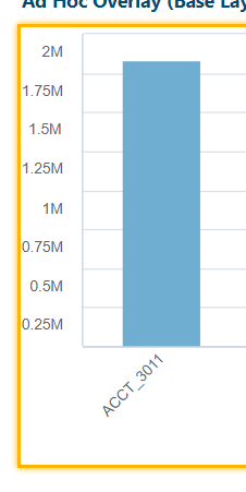

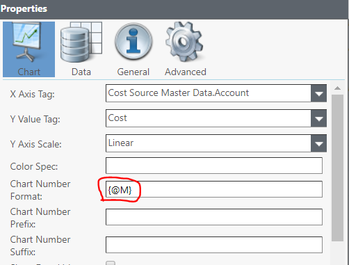

  • 6.  Re: Removing notations
    Posted 10/01/18 04:49 AM
    Hi Jesper,
    For the Overlay chart, this is what I did:
    I selected the Base layer, and then right clicked on the chart to view chart properties, in that this is what I did:
    Let me know if this what you were looking for.

  • 7.  Re: Removing notations
    Posted 10/01/18 06:09 AM
    I am looking for a way to remove the "M" from the numbers. I still don't see that effect. My numberformat was #,###.0{@M} already.
