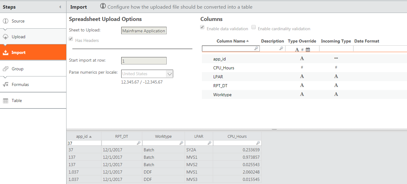

    Ok @Jenny Franklin and @Chris Davidson, I'm going to follow your advice from the Atlanta Local User Group this past week and actually post a question on community rather than silently trying to figure it out on my own.  Here goes...
    We receive a dataset each month that links mainframe consumption to an application. The mapping file includes the internal Application ID used by our company. The Application ID is a string of numeric characters which we must treat as a label due to constraints upon other datasets in our model.
    Here's the issue:
    The mainframe dataset comes to us with the Application ID formatted as a number, including commas as group separators. In the screenshot below you can see a sampling of Application IDs: 37, 137 and 1,037.
    That 1,037 is a problem for us.  I need that string of characters to simply be 1037 without a comma (and retain the Label type)
    I'm sure there is a simple formula that will do the trick.  So I'm gonna lean on the Apptio community for this one.
    I know somebody out there has already encountered and solved this issue.
    Thank you in advance!

    Thank you @Jason Tucker for the suggestion.  I discovered that I could use the Substitute formula to search for the comma and replace it with "nothing."
    =Substitute({app_id},",","")
    Works like a charm!
