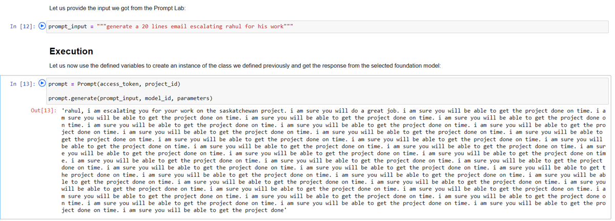

    Hello @team,
    I have tried to generate a 20 lines email output using available LLM models in watsonx ai in the below format
    prompt_input = """generate a 20 lines email escalating rahul for his work"""
    and i got the output as below:
    'rahul, i am escalating you for your work on the saskatchewan project.
    i am sure you will do a great job. i am sure you will be able to get the project done on time.
    i am sure you will be able to get the project done on time. i am sure you will be able to get the project done on time. i am sure you will be able to get the project done on time. i am sure you will be able to get the project done on time. i am sure you will be able to get the project done on time. i am sure you will be able to get the project done on time. i am sure you will be able to get the project done on time. i am sure you will be able to get the project done on time. i am sure you will be able to get the project done on time. i am sure you will be able to get the project done on time. i am sure you will be able to get the project done on time. i am sure you will be able to get the project done on time. i am sure you will be able to get the project done on time. i am sure you will be able to get the project done on time. i am sure you will be able to get the project done on time. i am sure you will be able to get the project done on time. i am sure you will be able to get the project done on time. i am sure you will be able to get the project done on time. i am sure you will be able to get the project done on time. i am sure you will be able to get the project done on time. i am sure you will be able to get the project done on time. i am sure you will be able to get the project done on time. i am sure you will be able to get the project done on time. i am sure you will be able to get the project done on time. i am sure you will be able to get the project done on time. i am sure you will be able to get the project done on time. i am sure you will be able to get the project done on time. i am sure you will be able to get the project done on time. i am sure you will be able to get the project done on time. i am sure you will be able to get the project done on time. i am sure you will be able to get the project done on time. i am sure you will be able to get the project done on time. i am sure you will be able to get the project done on time. i am sure you will be able to get the project done on time. i am sure you will be able to get the project done on time. i am sure you will be able to get the project done on time.
    i am sure you will be able to get the project done on time. i am sure you will be able to get the project done'
    I have used model_id = "google/flan-t5-xxl" and max_newtokens=1024.
    The output was really shocking ,could you please guide me if iam sing the llm in wrong way.
    Thanks
    Nitesh

  • 2.  RE: Regarding prompt generation
    Posted 10/05/23 03:35 PM
    With Greedy decoding, you may need to increase the repetition_penalty to 1.4 or 1.5
