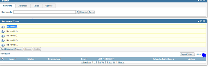

    Still getting the same error along with that Document types not showing after few pages in MWS.
    Is there any property need to set for showing all docs or is it the problem with fetching documents from DB.
    info: Sometimes It is showing all documents and sometimes getting the error like as “No results”
    please suggest on this.
    Attached the error image.
    Thanks in advance.
