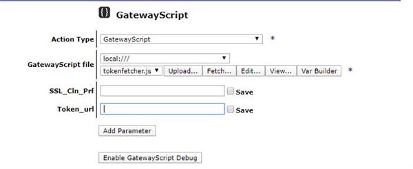

    Hello Experts,
    I'm stuck at an issue where i'm not able to understand how to proceed further.
    While using a transform action with an xslt, we can use the tab "Advanced" to set "Stylesheet Parameters".
    The same option to add Stylesheet Parameters under Advanced tab exists for the GatewayScript too.
    For accessing these in XSLT's I understand, I can use a <xsl:param to get the default value into the XSLT.
    But I cant seem to find how to do that for a GatewayScript.  Can anybody help with that.
    DP version: 7.6.0.4
    @Hermann Stamm-Wilbrandt your expert views on this please.​​​
    Ayush Singh
  • 2.  RE: Reading Stylesheet Parameters into GatewayScript
    Posted Fri February 21, 2020 02:28 AM
    Hi,
    This might be the thing you are looking for:
    https://www.ibm.com/support/knowledgecenter/SS9H2Y_7.7.0/com.ibm.dp.doc/session_js.html#session.parameters.parametername
    --Hermanni
