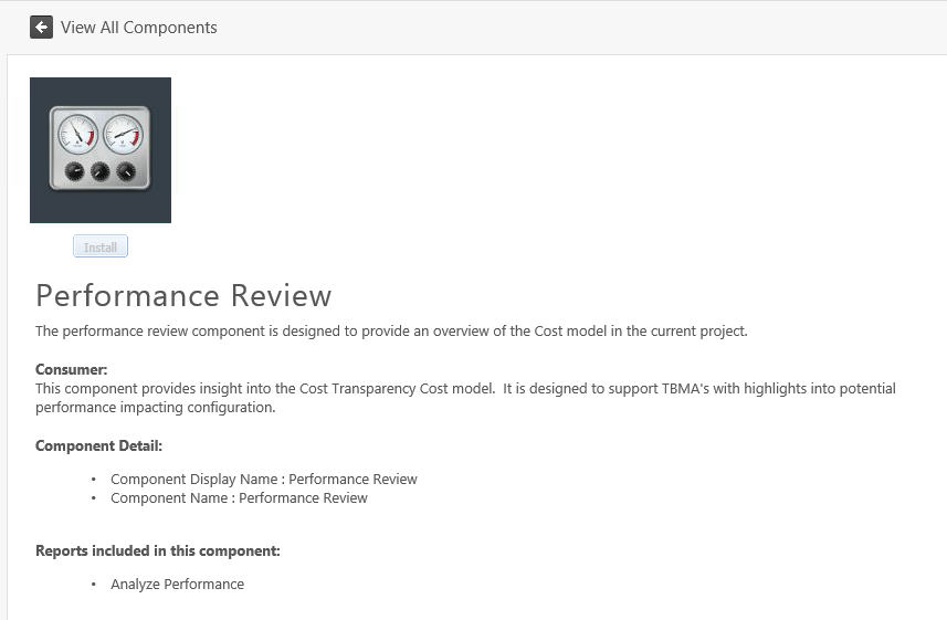

    @Francis Chinkwande, may I ask if you have any documentation on how you installed the Performance Analyser? We also upgraded to 12.5.1 a few weeks ago, but I do not see this component you are referring to in your post.

    I may have found it, @Francis Chinkwande. Is this what you are referring to?

    Hi Tony, I've only just seen your message, glad you managed to find it.
