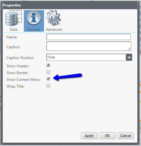

    You can add it from a table's Properties:
    1. Right-Click on the table
    2. Select 'Properties...'
    3. Navigate to the 'General' tab
    4. Check the box for 'Show Context Menu'
    5. Click 'OK'
    Table Properties Context Menu

    @Isaac George after selecting Show Context Menu, nothing appears (even with moving this around in the report), any ideas? Does this work for any Report table? Thanks!​​
    #ApptioforAll
  • 5.  RE: Re: R12 Export to Excel Question
    Posted 03/10/21 02:17 PM
    @Sam Colondro, It looks like this behavior has changed a bit.  You will need to add the "Show Header" option as well for the context menu arrow to show up.​
