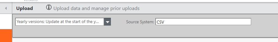

    We had two additional issues with file upload and we filed a ticket.  Below are the summary from support for your info.
    1.
    If you change Source System value (see screen shot) after you’ve uploaded a table, it will create a new version of the table and there will be a bug where you can no longer edit the table. The current solution is to delete the table and rebuild it.
