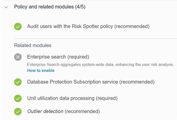

    Hello all,
    I'm trying to figure it out following issue:
    successfully enabled quick search from the CLI is not working after that from the GUI. Depending features are not available as well.
    from CLI:
    >grdapi enable_quick_search schedule_interval=2 schedule_units=MINUTE all=true
    >Quick Search is enabled.
    >ok
    check:
    >grdapi get_quick_search_info
    >ok
    From the GUI (see attached pictures) the depending features are not working and showing that quick search is still disabled. I have installed all available updates for ver. 11.
    Have you ever faced such problem? Can you give me a hint where I can find more details/logs?

  • 2.  RE: (quick) Enterprise search enabled, but not working
    Posted 10/07/19 02:54 AM
    ​Hi,
    we had this Problem with all V10.x Versions, happens especially if e.g. AGG / CM is down for some time.
    You have to run this command at all elements - COLL / AGGR / CM and wait around 1 hour -
    that helped at our Setup usually.

  • 6.  RE: (quick) Enterprise search enabled, but not working
    Posted 12/11/19 09:09 AM
    Hi,
    lernt from support last week that before running the provided Statement following component should be restarted ( valid from 10.6. on ):
    grdapi restart_solr restart_all=true
    But I have no Details About that "solr" daemon.
    Also after restarting the collectors processes at cm/aggr the same 2 command should be applied.
    My experience is:
    if collectors are for some reason in bad state ( overloaded ... ) the first thing which will stuck is quick search.
    Karl Riegler
  • 7.  RE: (quick) Enterprise search enabled, but not working
    Posted 12/12/19 03:51 AM
    Thanks for reporting on this. BTW, the command grdapi test_solr can be helpful when trying to figure out what's wrong.
    https://www.ibm.com/support/knowledgecenter/en/SSMPHH_11.0.0/com.ibm.guardium.doc.admin/tshoot/investigation_dashboard_no_results.html
