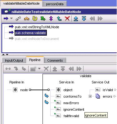

    When I move the validate step to just after the pub.xml:xmlStringToNode step, I get the following error:
    com.wm.app.b2b.server.ServiceException: [ISS.0062.9024] Integration Server does not support this type of object in validation _DOCUMENT_ System ID: null Public ID: null [/i]
    [ISS.0062.9024]Did you insert a pub.xml:queryXMLNode step after the xmlStringToNode step?
    See attached screenshot of my current service.
    Mark

  • 5.  RE: pub.xml.schema:validate not handling elements containing xsi:nil="true" attributes
    Posted Wed October 11, 2006 12:30 AM
    OK, you validated the node against the IS schema rather than the doc type. Works for me now.
    So, in summary, if an element contains an xsi:nil=“true” attribute, it will fail validation if validating an IS doc against an IS doc type, but will pass validation if validating a node against an IS schema.
    That’s broken, but perhaps workable.
