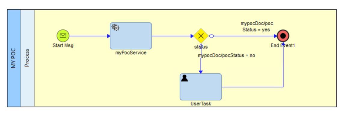

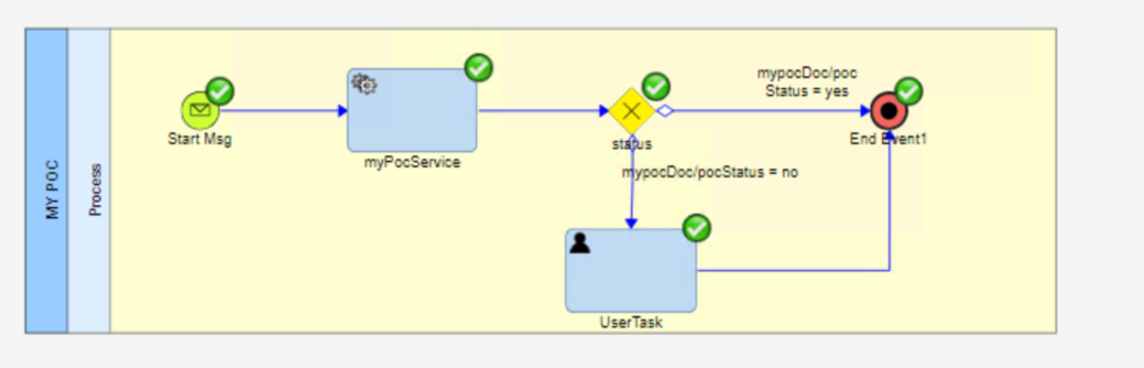

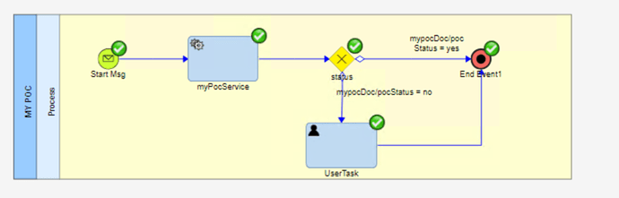

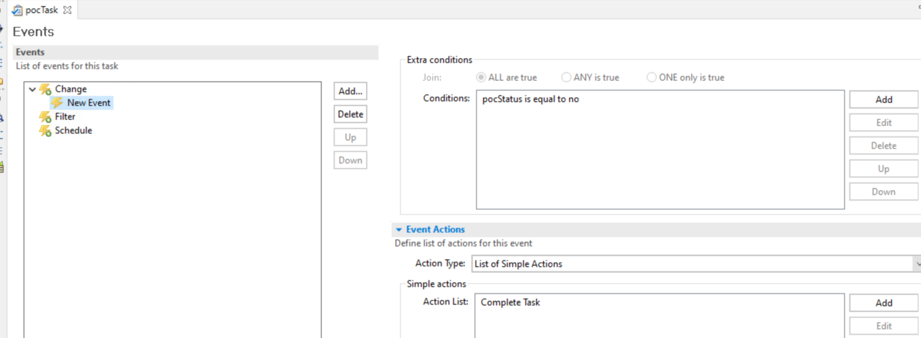

I have created BPM process with Task. When i publish document the user task returning following error.
Process Error:
com.wm.app.prt.ProcessException: [PRT.0101.9125] Service MyPOCProjectBPM.myPOCDemo.myPOCDemo_1.Default:UserTask_InputMapService failed. com.wm.util.BasisException: SOAPException( Server.userException: [POP.001.0002] A “java.lang.NullPointerException” occurred with the Message “null” ) at com.wm.util.BasisRuntimeException.(BasisRuntimeException.java:86) at com.wm.app.b2b.server.ISRuntimeException.(ISRuntimeException.java:194) at impl.TaskEngineMWSImpl.queueTask(TaskEngineMWSImpl.java:130) at pub.task.taskclient.queueTask(taskclient.java:80) at java.base/jdk.internal.reflect.NativeMethodAccessorImpl.invoke0(Native Method).

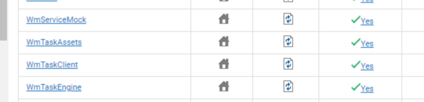

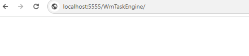

WmTaskEngine: When i tried to open WmTaskEngine Home page showing empty.

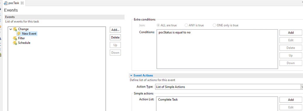

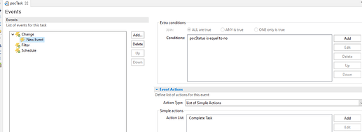

Also. I have enabled the debug log for this service "MyPOCProjectBPM.myPOCDemo.myPOCDemo_1.Default:UserTask_InputMapService " in the pipeline the inputs are present. After passing inputs to “pub.task.taskclient:queueTask” service returning “SOAPException( Server.userException: [POP.001.0002] A “java.lang.NullPointerException” occurred with the Message “null” )”. But when we pass default Task id, no issues.
