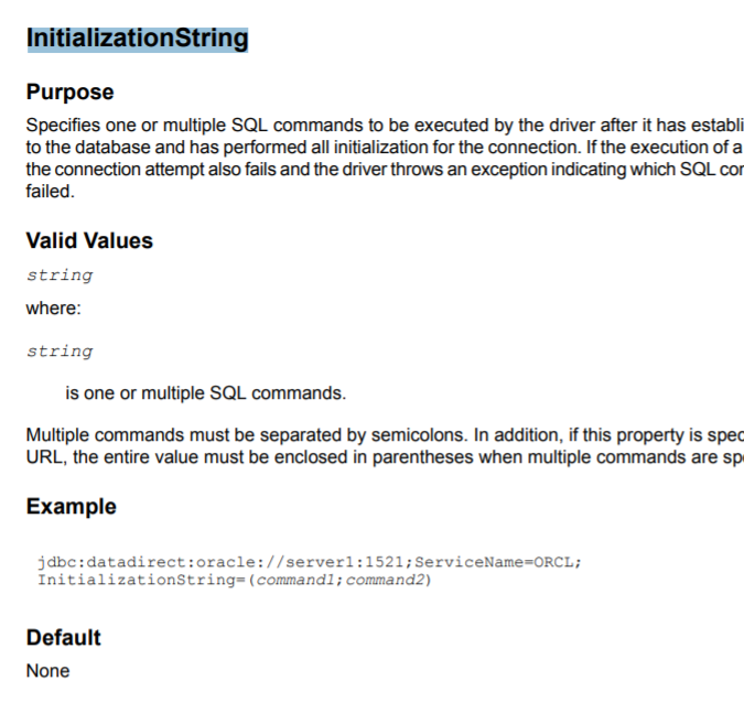

  • 2.  RE: Property to set current schema in JDBC Adapter connection
    Posted Thu December 09, 2021 04:36 AM
    Hi
    It depends on the type of driver you are using.
    If you are using oracle drivers then you should use - ‘currentSchema=myschema’ in other properties.
    If you are using Data Direct drivers then you can use InitializationString as "ALTER USER user_name SET search_path to ‘schema’‘’

  • 6.  RE: Property to set current schema in JDBC Adapter connection
    Posted Thu December 09, 2021 07:38 AM
    You should try this.

  • 7.  RE: Property to set current schema in JDBC Adapter connection
    Posted Thu December 09, 2021 11:09 AM
    I have driverType=thin. I added the InitializationString as advised but I think it’s ignoring it altogether.

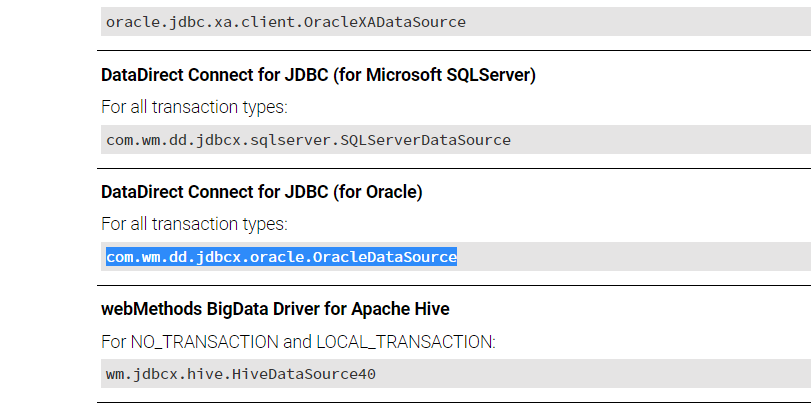

  • 8.  RE: Property to set current schema in JDBC Adapter connection
    Posted Fri December 10, 2021 12:21 AM
    Hi
    You should use data direct drivers shipped out of the box to get this working. not Ojdbc driver.
    For Oracle the driver class is “com.wm.dd.jdbcx.oracle.OracleDataSource”
    https://documentation.softwareag.com/webmethods/adapters_estandards/Adapters/JDBC/JDBC_10-3/10-3_Adapter_for_JDBC_webhelp/index.html#page/jdbc-webhelp%2Fta-config_adap_jdbc_conn.html%23
