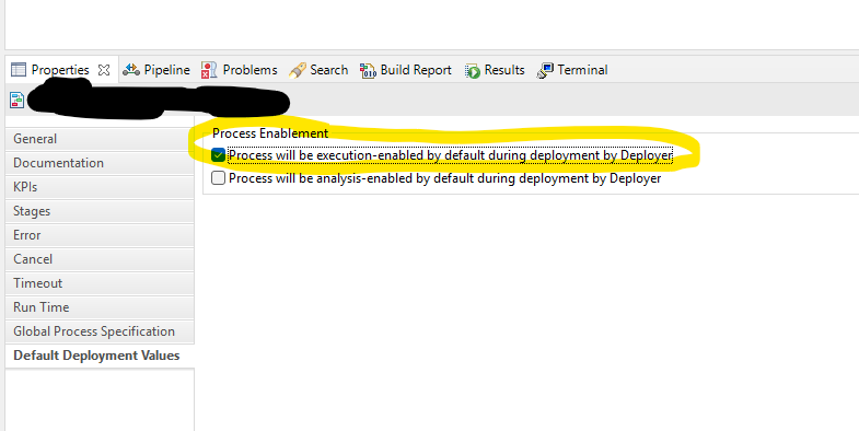

    For deployer to enable process after execution, this property (Enable process for execution) needs to be set to Yes. Unfortunately I don't know the correct property syntax. If you have a deployment project, you can update it directly from there, or you can create a new one, set this property to Yes, and then list the properties using the command in the documentation below the screenshot.
    displaying project properties
    Alternatively, you can enable it manually (with a service call after deployment, there must be a service for this task but it may require some digging as I don't know which service does it).
    Or you can set it in Process level so that it will be enabled by default during deployment, but this requires access to the process code.

    hi engin ,
    thanks for your response, i would like to know the version of your deployer and which page cloud enter the page of your screenshot , thanks a lot !
