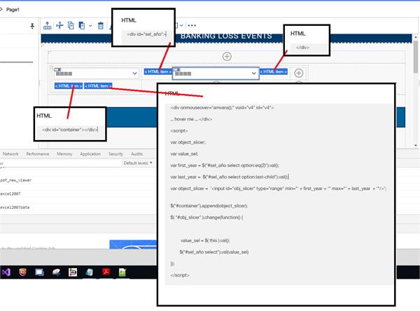

    Hi @Ralf Roeber,
    Y try your code and the output show me that 'There is a JQuery in parent scopre. So we can use that one.'.
    Does it means that the report have loaded the JQuery library but when we put the <html item> this item run in another scope and the JQuery don't load inside it? I dont understand in what place i need to put my jquery code for that it work well.
    I try this code but dont work:
    <div onmouseover="amvara();" void="v4" id="v4">... hover me ... </div>
    <script>
    var object_slicer;
    var value_sel;
    var first_year = $("#sel_año select option:eq(2)").val();
    var last_year =  $("#sel_año select option:last-child").val();
    var object_slicer =  '<input id="obj_slicer" type="range" min="' + first_year + '" max="' + last_year  + '"/>';
    $("#container").append(object_slicer);
    $( "#obj_slicer" ).change(function() {
    value_sel = $( this ).val();
    $("#sel_año select").val(value_sel)
    </script>
    This code get two years of an prompt,
    create a slicer html,
    insert the slicer in the report and finally set the value that the user choose in the slicer into the prompt.
    With the code above dont work. If i put implicity the jquery library works but the prompt autosubmit and other properties of it stop working.

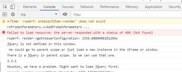

    Thanks for your quick answer again. I try your code but something is wrong initiallitiating the JQuery.​ The output of the console show this:
    This is the code that i try (only the initialitatin part):

  • 10.  RE: Problem with Cognos report with JQuery
    Posted Tue January 21, 2020 12:12 PM
    if (typeof myjQuery == 'undefined') {
        console.log('Houston, we have a problem. Might want to load jQuery first.')
    to
    if (typeof myJquery == 'undefined') {
