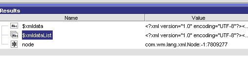

    We have recently upgraded our server from version 6.2 to version 8.2.2 and after that there are problems with one of our customers posting xml data to our servers.
    The service exposed customer is a wrapper to wm.tn.doc.xml:routeXml; receives an XML via http post and routes the document to TN. in 6.5 it was working perfectly and in 8.2 it stopped working (only for this specific customer and customer confirmed no changes at their end; the same request routed to 6.5 server works fine).
    When we checked the pipeline in 6.5; we can see the below list of variables placed in pipeline of the service for the http request
    1. $xmldata ------> String with the complete XML string
    2. $xmldataList —> StringList with complete XML string in position 0
    3. node ------> XML node (Our service processes the node and ignores the rest)
    In 8.2 there is no data available in pipeline most of the time. or sometimes a httpContentStream which when we try to restore it does not work.
    Have any one faced this kind of issue with 8.2.2.
    Any changes to http request handling behaviour in 8.2 vs 6.5?
    Thanks!
    Deepan

    Thanks for your reply; however as i mentioned in 6.5 we can see the below placed in pipeline by the server
    however we do not see any data being placed into pipeline in 8.2.2

    ok. the problem is not with saving pipeline (it could be posted as stream/bytes). this what my pipeline looks if restore in 6.5.
    [ATTACH=CONFIG]872[/ATTACH]
    however i do not see any data being placed in pipeline for the same service in 8.2.2. so document gets routed to TN. I suspect a change in behaviour with respect to http request handling in 8.2.2; any pointers would be helpful.

    -update for the issue with http requests–
    customer was sending XML as URL encoded which was not recognised by 82 IS, customer agreed to change in their side to remove the url encoding and test went ok.
    other way we could resolve this is write a custom content handling service, extract the xml string from contentStream then decode the url encoding to get the xml string.
    Strange, that same request was accepted in 65 but not in 82, may be we missed some server settings or parameters??

    I have no chance to look at how customer is sending data. however this is my observation
    1. The xml sent by customer is URL encoded - %3C for <, %3E for < etc…
    2. This request when sent to 65 server it is recognised and IS places “node” in the service pipeline
    3. When sent to 82 server, this is not recognised and we get “contentStream” in pipeline; when converted to string, we get the URL encoded XML.
    I wish nothing changed in the standard stuff; still wondering any settings or other parameters causing this.
