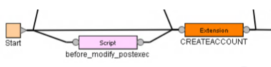

    So, add postexec attribute value to account you are creating before create operation in operational workflow.
    I have it in script node just before create node.
    Snipet from script node in workflow:
    // set value for postexec
    acc.setProperty("postexec", "c:\\ad_adapter_exec\\postexec_test.ps1 " + '"EZ.' + eruid +'"');
    Esentialy, sets postexec value to execute postexec_test.ps1 with some $args.
    Result will be something like this:
    powershell.exe -executionpolicy remotesigned -File c:\\ad_adapter_exec\\postexec_test.ps1 EZ.NhesterC
    Then you need to handle that attribute in PS script, and use it as user for home directory creation.
    I used param further down in PS script.

    You should NOT hardcode the script in the workflow - if you do so you have to have an ISIM administrator to maintain this (and it will need to be maintained from my experience...). Instead create some custom service attributes/custom service tab (extend the service schema and add these to the service form) and put the script there and then retrieve the script from there when you need it.
    This way you can make externalize the maintenance of the actual script to the service owner or whoever is maintaining it - not need to have people fiddling around in the workflow editor...
