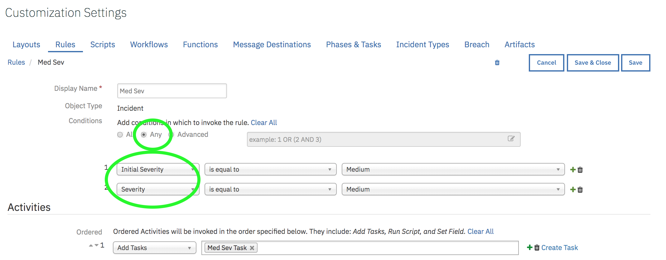

  • 8.  RE: Playbook Optimization
    Posted Wed March 27, 2019 05:44 PM
    Edited by Brenden Glynn Wed March 27, 2019 05:48 PM
      |   view attached
    Amit,
    Some questions to help me understand your goal.
    1. Are the number of tasks for High (25), Medium (19), and Low (13) all unique to the specific Severity Level? Or are some of the Tasks shared between Severities/overlapped. For example are some of the Tasks in Low, also in Medium?
    2. How often is the Severity changed? Is it a one time event, or is it possible it will change many times through the life of the Incident? In either event, you'd want to track that the severity was changed. The Initial Severity and the Final Severity. This will help you track overtime if Severities are changing on Incidents, and possibly uncover trends.
    If the Severity is changed only once, you can set the conditions on the Medium Rule to (see attachment/screenshot)
    This will allow an Incident that went from Med->Low and Low->Med to maintain the Medium Tasks. The moment both of them no longer = Medium though, the Medium tasks will disappear.
    Note: The Rules engine will Add Tasks when the conditions evaluate to True. The point when that Rule that added the Tasks no longer evaluates to True, it will remove the added Tasks (as you've experienced).
    3. 32 Tasks on an Incident is a lot of Tasks! I would recommend 15-20 at most if possible. I would consider consolidating some of those Tasks together.
    @Pablo
    All Rules will evaluate if the Rule type is triggered. It wont matter if you put a Rule at the top or bottom. They don't operate like ACLs. They don't stop when there is a match. You determine the order of the Rules based on the impact they will have to each based on their Activities.
