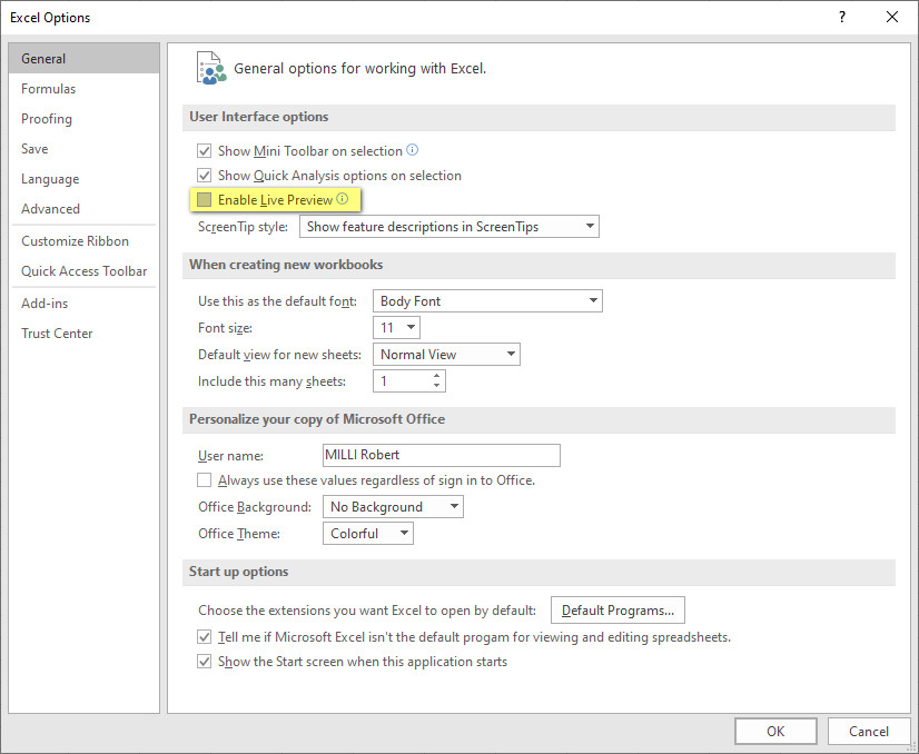

  • 20.  RE: Perspectives V11 / TM1 formulas return NA
    Posted 12/16/20 09:37 AM
    Hello,
    Thanks to @frédéric Mallaval we've got a solution which works pretty well : Disable "Enable Live Preview"
    Excel option
    We noticed also that our Excel version has some upgrades which were not applied and which could also help.
    Let us know if it change something for you.
