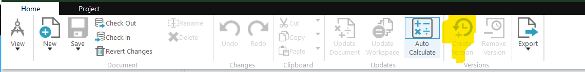

    Hi @Guy Beletsky,
    we did earlier what @James Funk proposed but we came to a point were the formulas got very messy after a while and not anymore maintainable.
    We switched to work with versions of tables:
    Downside is that you need to be aware that the formulas are changing depending on the version you are currently looking at. Hence, from one month to the other formulas might change. At the beginning it was also confusing but as soon as we got used to it, it is better maintainable than the =currentdate forumals.

    Thanks guys, this is helpful. And I agree that using formulas for this is only good if it doesn't make the logic convoluted and hard to follow/maintain.
    Looking at the "Create Version" feature, it looks pretty convenient to use - if you see the "Remove Version" button clickable, it means you have multiple versions, and by hovering over this button on various months you can figure out what periods the versions are for.
    Thanks!
