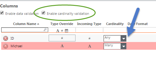

    What i can see is that we no longer get the error pop-up, although there are visual clues on the upload table.
    For cardinality changes you will need to select this as an option, and what you expect to see in the product
    Enable Cardinality
    Once you have done this, if you break any of the data validation rules, you will see an error number next to the import item on that table.
    Data validation indicator

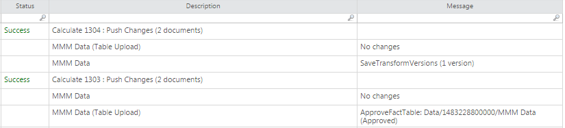

    However, the log file does not show this as an error
    Upload Log
