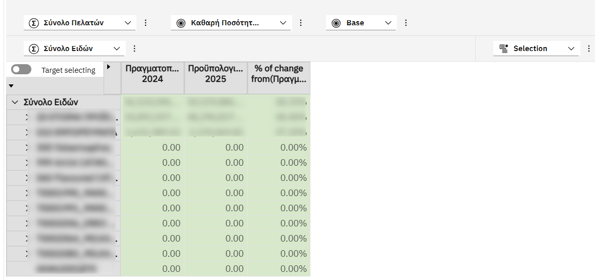

    I'm trying to create a report that has the actual sales of current year against the budget sales of next year. The only possible way to achieve this (getting the intersection of year and version) is by using MDX. Although, I need my report to be dynamic and get the required years and versions based on user's preference.
    So, I created a process to pass, dynamically, the user's preference and update the view. I chose to this solution because I don't know if there is any other way to change the MDX query dynamically on a report.
    Below you may see the report (using data explorer as widget: on row are materials, on columns Actual of 2024, Budget of 2025 and the last column the % of change. The issue that I have is that the data explorer widget is not updated when I run the the process and change the year or the version of data that I want to compare.
    I'm also providing the mdx that I used to create this report as well as a sample of parametrized MDX that I use in process.
    WITH MEMBER [D_Years].[D_Years].[Actual 2024] AS ([D_Years].[D_Years].[2024],[D_Versions].[D_Versions].[Actual]), SOLVE_ORDER = 1 MEMBER [D_Years].[D_Years].[Budget 2025] AS ([D_Years].[D_Years].[2025],[D_Versions].[D_Versions].[Budget]), SOLVE_ORDER = 2 MEMBER [D_Years].[D_Years].[% of change from(Actual 2024 , Budget 2025)] AS ((([D_Years].[D_Years].[Budget 2025] - [D_Years].[D_Years].[Actual 2024])) /  CASE   WHEN [D_Years].[D_Years].[Actual 2024] < 0 THEN 0 - [D_Years].[D_Years].[Actual 2024]  WHEN [D_Years].[D_Years].[Actual 2024] > 0 THEN 1 * [D_Years].[D_Years].[Actual 2024]  WHEN [D_Years].[D_Years].[Actual 2024] = 0 THEN 0  ELSE NULL END ), SOLVE_ORDER = 3, FORMAT_STRING = '##0.00%;-##0.00%' SELECT {[D_Years].[D_Years].[Actual 2024],[D_Years].[D_Years].[Budget 2025],[D_Years].[D_Years].[% of change from(Actual 2024 , Budget 2025)]} ON 0, {DRILLDOWNMEMBER({[D_Είδη].[D_Είδη].[Total of D_Είδη]}, {[D_Material].[D_Material].[Total of D_Material]})} ON 1 FROM [F_Πωλήσεις] WHERE ([D_Customer].[D_Customer].[Total], [D_Measures].[D_Measures].[Quantity], [Sandboxes].[Sandboxes].[Base])

  • 4.  RE: PAW Dynamic MDX report
    Posted 12/10/24 10:42 AM
    Dear Pantelis:
    Thanks for all the detail. I think I understand the problem now. I am short of time right now so I haven't had a chance to digest everything, but I just wanted to share a thought.
    For this kind of problem I would probably have explored the approach of having the TI process update a report variables cube dynamically with the desired parameters, and then have the report MDX just look up the values in the cube. I would NOT use ViewCreateByMDX to rebuild the entire report MDX each time. The MDX would just live in the report (PAW Book) itself and dynamically reference whatever the report variables are.

  • 5.  RE: PAW Dynamic MDX report
    Posted 12/11/24 03:01 AM
    Dear Ann,
    Your suggestion "MDX would just live in the report (PAW Book) itself and dynamically reference" gave me a way to direct. This lead me to the article create-dynamic-asynchronous-views-with-mdx which provided me the solution because I already have a configuration cube.
