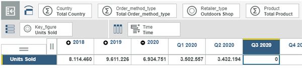

    I have a Problem with the relative proportional data spread in PAW.
    My Version is 2.0.52
    When I try to copy value from Q3 2019 into Q3 2020, Nothing happens.
    Please see attached screenshots.
    I am Administrator in PAW and in the TM1 database.
    Same action in architect works fine.
    After this action value is still 0.
    Can anyone help?
    Thanks and Regards
    Tim

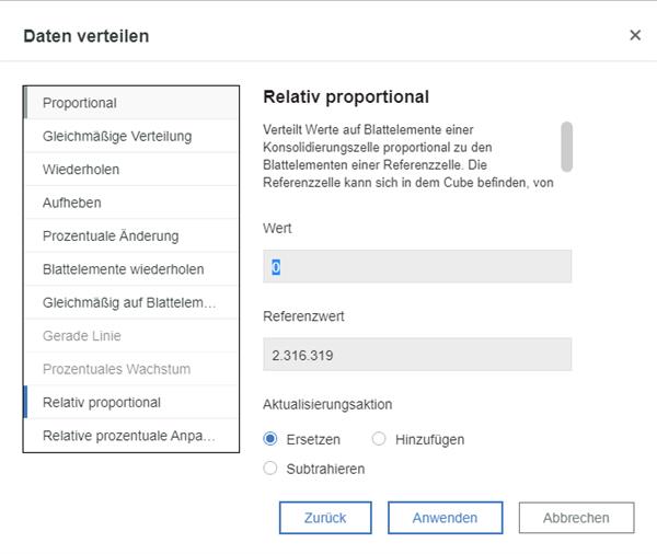

  • 2.  RE: PAW Data Spread Issue
    Posted 06/24/20 03:11 AM
    Hello Tim,
    Have you entered the number you want to spread in the first field "Wert" ?
    This value is pre-populated in Architect with the reference value not in workspace, you need to enter the target value by yourself (it could be the same or a different value from the reference value).
    Regards,
    Florence Mougnaud
  • 3.  RE: PAW Data Spread Issue
    Posted 06/24/20 03:26 AM
    Hi Florence,
    that worked, thank you!
    Thought that the field "Wert" isn´t editable….
    Best Regards
    Tim
