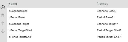

    Has anyone else noticed that the parameters on PAW Buttons change order from how you set them to alphabetical?
    My process is set up to prompt per below image.  When setting parameters or running the process from the button, order seems to sort alphabetically. Only noticed this happen recently, possibly a PAW 2.0.57.
    Process order

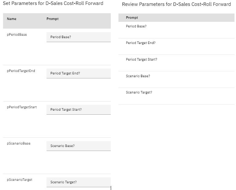

    Set Parameters and review on run:
    Alphabetical

    I would qualify this as a bit of a minor defect.  The order does appear to be correct in the button properties, just not the prompt when you run the TI process by clicking the button.  We should probably fix this so the parameters are displayed in the order they were set in the TI.  Longer term, I would also like the Workspace book author to be able to set the order of parameters (override what the order set in the TI).
    Thanks for pointing this out!
