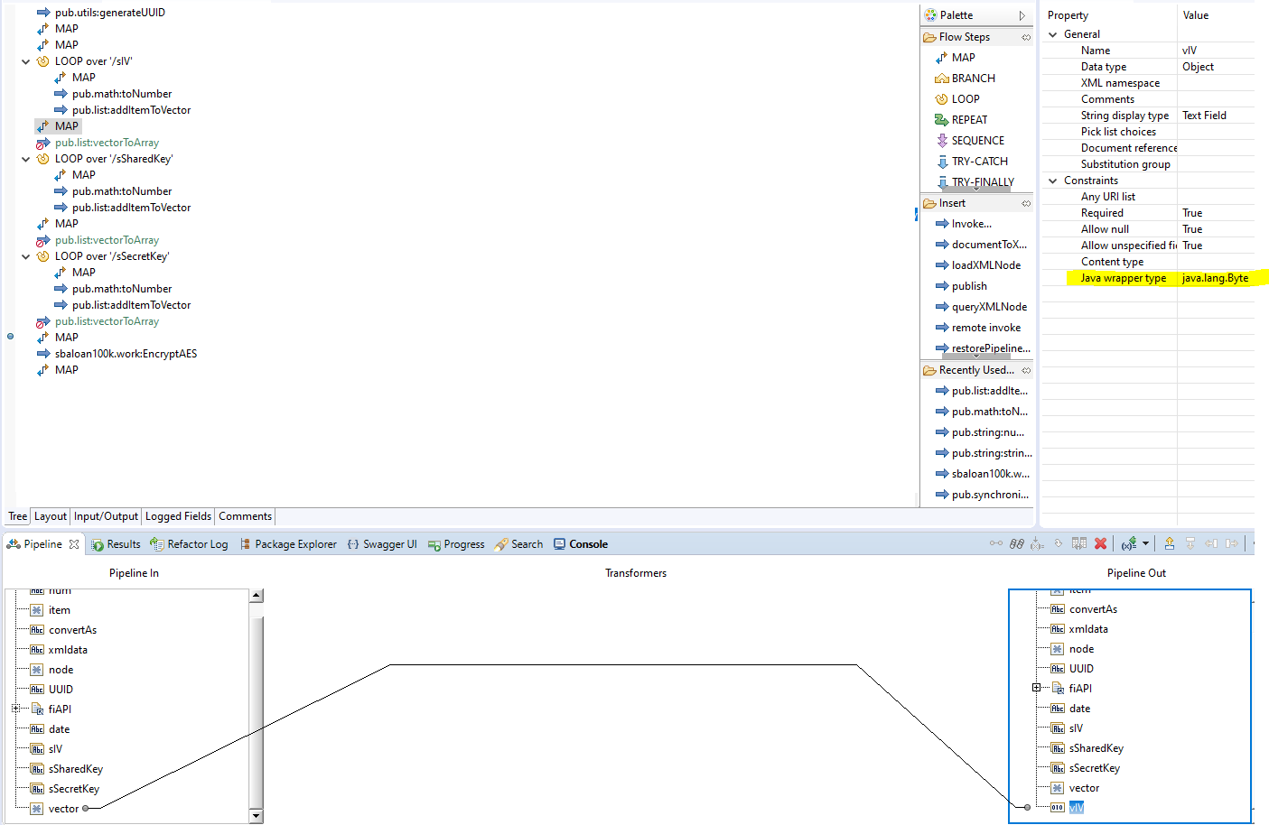

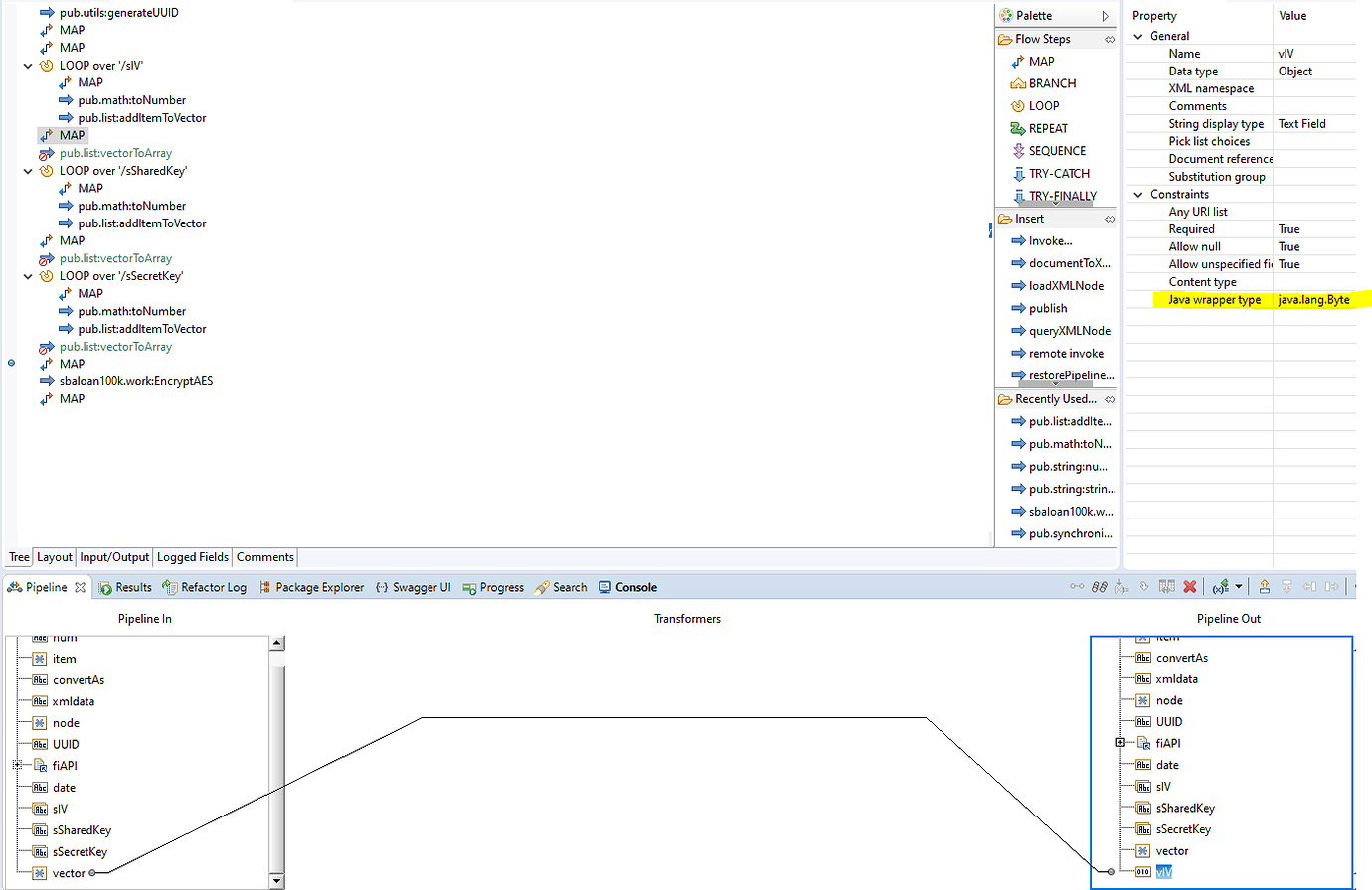

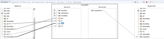

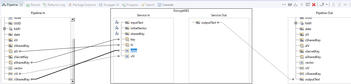

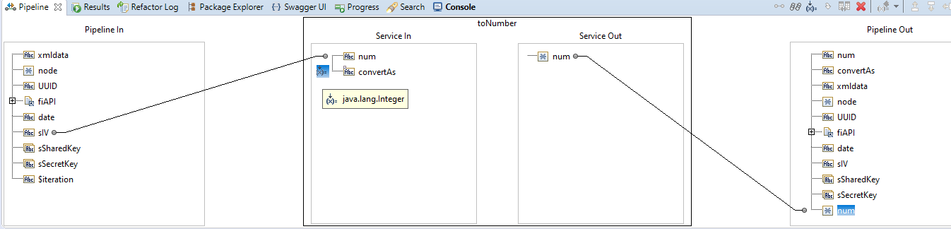

    I have been trying to revise my code which calls an encryption service. Instead of embedding the key and initial vector (IV) in the Java Service I was going to pass it as a object[] and then convert it to a byte[]. I also tried a object and then convert it to a byte[]. So far I have not had much luck. Note: in a normal Java app it all works fine. I have a string containing the numerical values of the key and IV which are comma delimited. Example: String key = “1, 2, 3, 4, 5, 6, 7, 8, 9, 10, 11, 12, 13, 14, 15, 16, 17, 18, 19, 20, 21, 22, 23, 24, 25, 26, 27, 28, 29, 30, 31, 32” and String iv = "“1, 2, 3, 4, 5, 6, 7, 8, 9, 10, 11, 12, 13, 14, 15, 16”

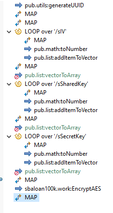

    1. I run it through a MAP transformer to tokenize it into a String List.
    2. loop over the string list and convert it to a number using pub.math.Number (setting convertAs to Integer)

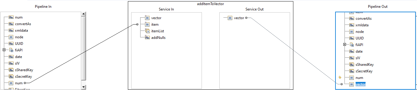

    3. Once this is done I call pub.list.addItemToVector adding the num object to a vector array object
    4. Then I map the vector object to my newly created object in pipeline Out.
    5. Then I call my Java service passing the new object in
    I sense I am missing a step, but before I embed the key and IV into the Java service (not desired) I would like to know how to pass a proper object into the service. Do I use pub.string:stringToBytes then add it to the Vector? The Cipher.init() is failing with
    java.lang.IllegalStateException: Cipher not initialized
    If there is an alternative I can achieve the same within the flow service let me know.
