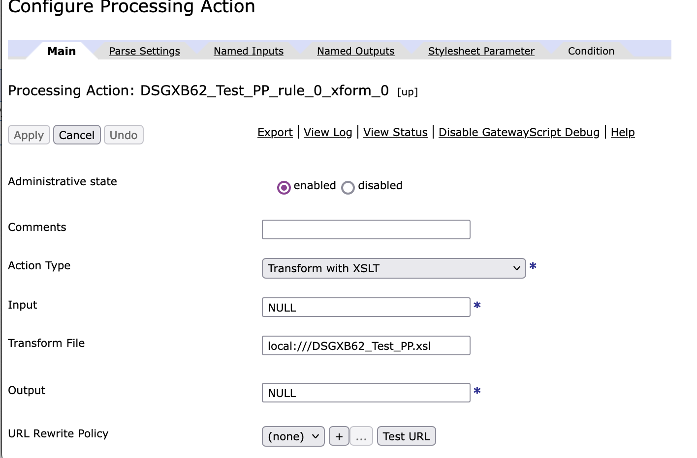

    I noticed a difference between the two DP instances in the transformation rule of a processing policy:
    The new (failing) had 'INPUT' and 'OUTPUT' on their respective fields, and I changed it to NULL to match with the K8s instance. Do you think this may be related to the issue?
    Certainly, since having INPUT as NULL means the policy won't attempt to parse anything on INPUT.    I suspect the DSGXB62_Test_PP.xsl isn't attempting to process anything in the flow.

    Just closing this, and for the record in case is of use to anyone.
    The solution above solved the issue.
    The content of DSGXB62_Test_PP.xsl I can not share, but it seems to be used for routing to different destinations, instead of processing the content of the file.
