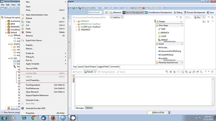

    Whenever I used to lock the package .Its not getting highlighted…

    Not getting highlighted? Are you able to click on unlock or the selection itself is not happening?
    Is it possible to share a screen shot of the issue you are facing.

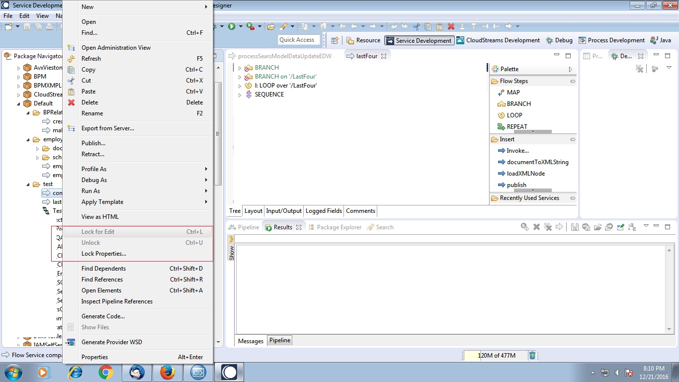

    You can see the attachment that those options are not getting highlighted…so that Im not able to edit the Services
