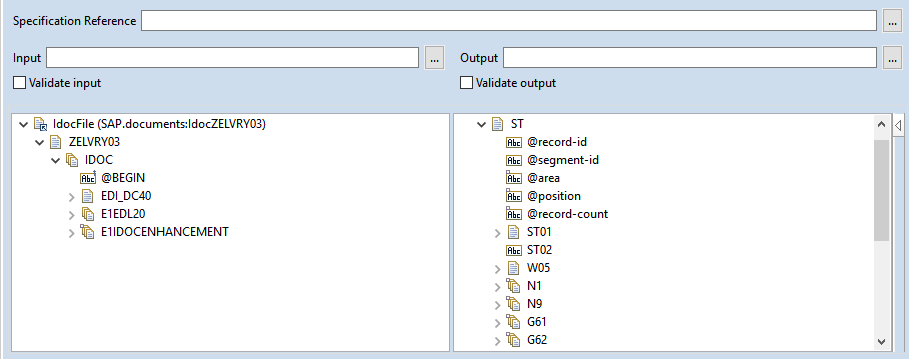

    I have a flat file that contains and IDOC (we batch outbound data from SAP in our current environemnt). Anyhow, the flat file has a different IDOC segment every record (EDI_DC40 , E1EDKA1, etc.) all in order. I created a new document type in Designer and had it connect to our SAP DDIC and pull down the IDOC definition. I’m just starting my first outbound EDI map (940 from IDOC) and I’m not able to load the input file when I try to run the flow service. I get “Unable to parse input file.” I’m suspecting or wondering if it’s because the definition pulled in by WM from SAP has a top node of the IDOC type with a couple indented nodes (DELVRY03 → IDOC → EDI_DC40, all the records after that in a hierarchical-looking foramt) and my flat file from SAP isn’t written like that. As I said, it’s just one record after the other starting with the EDI_DC40 record. Would that cause this issue?
    Also, I’m doing the individual segment mappings and in the header segment, there’s a value I’m needing to pull from later on in the IDOC. On the input side of the segment maps, I assume I load the entire doc reference pointing to the IDOC document as the input and then the entire 940 DT created by WM on the output. Is that correct? I don’t seem to be able to map over the fields later on in the IDOC to the EDI document in the map. I can drag the mapping link but it doesn’t stay and the mapping button isn’t available either.

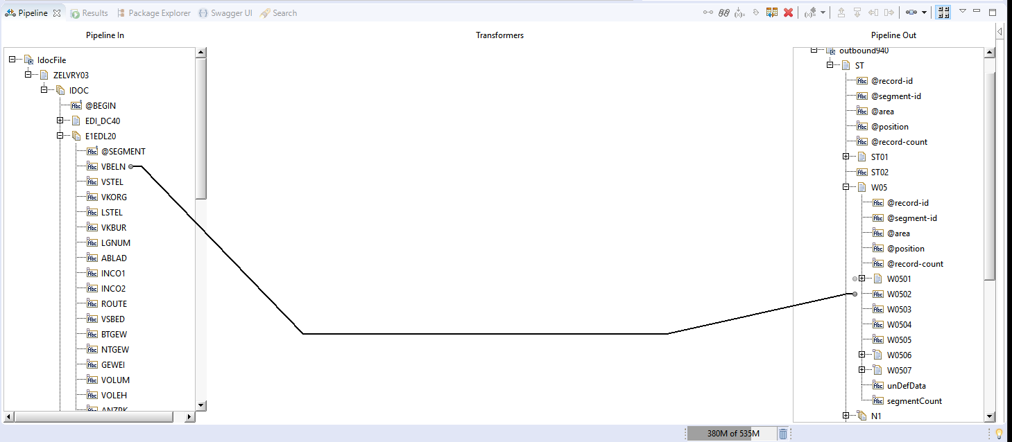

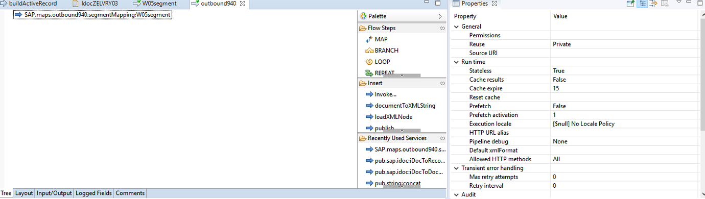

  • 3.  RE: Outbound IDOC mapping help needed
    Posted 04/28/20 01:57 AM
    RMG,
    Thanks for your response. I’ve attached just a couple screenshots to see if this helps. I can’t copy in the IDOC file of course, but like I said, it’s just one IDOC segment per record - not hierarchical like the document type created when I pulled the definition down from SAP. I’m showing you the main map flow which only has the one call to the segment mapping for the W05 (IDOC → 940) and this is the first segment in the EDI transaction. I’m still getting the unable to process input file right now.
    Any guidance?

  • 4.  RE: Outbound IDOC mapping help needed
    Posted 04/29/20 01:08 AM
    OK will take a look.
    But as per your screen shots it shows a straight fwd mapping you had in place for segment mapping and main mapping not very clear where you getting stuck at this point?
    How are you trying to process/running the main service providing the IDOC ZELVRY03 and able to see it correctly in the pipeline as IdocFile IDATA object (document reference) as defined in your main service I/p??
    HTH,
    RMG
