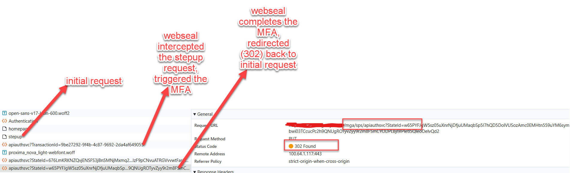

    i have attached the network trace below for your reference, after webseal completes the MFA process its doing 302 from /apiauthsvc to the initial request. I am confused about how /apiauthsvc is triggering a 302 redirect in this scenario. This issue is hindering our development progress.

    1. is this true statement? for /authsvc services webseal will automatically redirects(302) back to the original request after MFA completes
    2. For /apiauthsvc service, webseal doesn't support redirect(302) automatically right after MFA completes?
    3. For the /apiauthsvc service flow:
               a.) The frontend app calls the backend resource.
               b.) Webseal intercepts the request and triggers MFA.
               c.)  After entering the OTP code, Webseal sends a 204 response back to the frontend app. If Webseal returns only a 204 response, the frontend app then call the same backend resource                  for a second time, ensuring that Webseal does not intercept it again.
    Is Scenario-3 the best practice? Or do you suggest another approach?
    Thank you in advance for your assistance here.

    This might be related to changing the default values for the EAI Flags:
    https://philipnye.com/2014/12/18/isam-for-web-webseal-stream-eai-authentication-response-to-browser/
    In the Reverse Proxy Configuration File:
    [eai]
    eai-flags-header = am-eai-flags
    If the value isn't the one above, it will revert to similar behaviour as the standard Authsvc.
