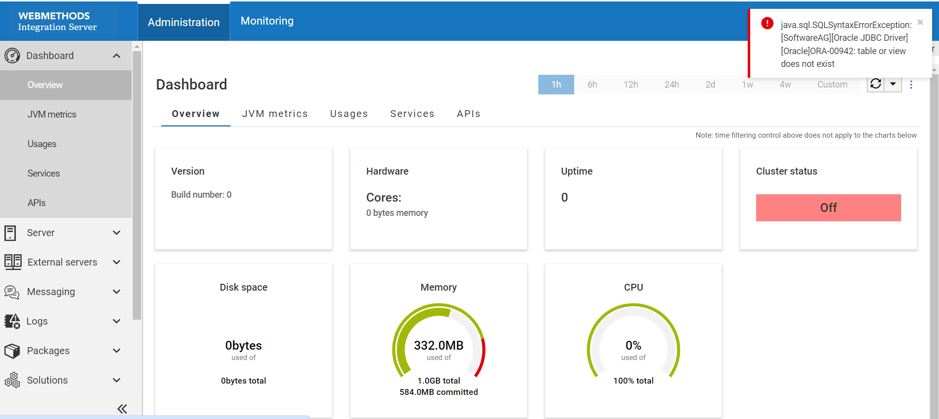

    Hi everyone,
    when i started the integration server the below error is popping up and also i could not configure the my webMethods server while configuring the database component configuration the same error is occurring .
    java.sql.SQLSyntaxErrorException: [sag-cjdbc42-0011][Oracle JDBC Driver][Oracle]ORA-00942: table or view does not exist
    currently I’m using webMethods 10.15 and oracle sql developer.
    Thanks in advance,
    ArunaSri.

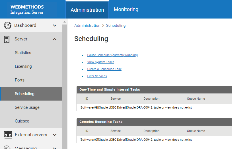

    Posted Mon May 06, 2024 11:16 AM
    Hi Arunasri,
    did you resolve the issue, I am facing the same and I see in scheduler’s it is not able to connect to the DB and throwing an exception as attached.
    Let me know if you get the solution for this.
    FYI… I used to connect when I installed initially after some time it has started throwing exception.

  • 6.  RE: ORA-00942:- table or view does not exist
    Posted Mon May 06, 2024 11:50 AM
    Hi Madhava,
    is there anything in the logs, which table or view cannot be found?
    Did anything change to your installation, when the exception started to occur?
    Regards,
    Holger

  • 7.  RE: ORA-00942:- table or view does not exist
    Posted Mon May 06, 2024 11:51 AM
    sorry, its my bad, unfortunately I have used wrong schema (some how it got updated since installed :frowning: ).
