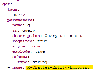

    Hi @suke ,
    Please see below un-encoded characters (i.e %2F, %3A and + sign) in the response data. There are more of these within the response data.
    In the open API specification, I’ve tried to play around and add some encoding properties but so far no luck. I recently added below value but data are still not being encoded in the response
