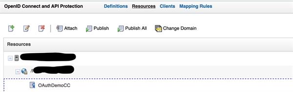

    Did you attach the protected resource with the API protection policy  you created for Oauth/Auth flow?
    Auth Code Grant Sample
    Manish
