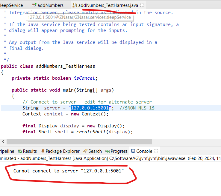

    not able to debug the java service due to below
    Error :Cannot connect to server “127.0.0.1:5001”
    Can any one suggest what could be the issue ?

    Hi,
    hopefully, you have checked that the server was started on the same machine on the mentioned port, before trying to test the service.
    If so, there should be a more detailed error message, why the test service cannot connect to the service to be tested.
    You might want to edit the main()-method, so that you can pass the server in the args on the commandline.

    On the machine where you are using Designer (i.e., localhost), open a browser and try to access this IS. Make sure that you can reach the server via the browser, before you try again in Designer.
    There could be multiple reasons - server online on the right port (as Holger says), or the port not being open for connections (firewall rules) even if it’s on your own/same machine.

    The 5001 port is https port .
    I have tried it bypassing the http port too but I thing needed to do some other setting in designer
    in General > network connections.
    can you guys suggest how to do that .
