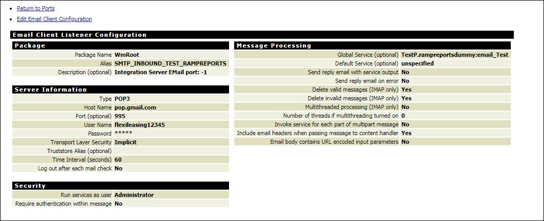

    I have already configured my port and I am able to view the sender details.
    However I am able to see null data inside the email/content after testing.
    Also I am getting error as below
    [175]2018-12-18 10:41:57 EST [ISP.0068.0013W] Error processing service: [ISS.0068.9006] Server Error: [ISS.0086.9249] Missing Parameter: inputStream
    [174]2018-12-18 10:41:57 EST [ISP.0068.0025D] No content handler for content type multipart/alternative. Service TestP.rampreportsdummy:email_Test called without content handler.
    [173]2018-12-18 10:41:57 EST [ISP.0068.0004T] Processed 1 new message(s)
    [172]2018-12-18 10:41:56 EST [ISP.0068.0026D] Content type: multipart/alternative; boundary=“0000000000004722dc057d4dbb64” Subject: TestP.rampreportsdummy:email_Test
    I have configured gmail settings on my port.Attaching the screeshot.
    Also I have assigned a object of name “contentStream” on the input.
    But looks like the data is not getting transferred to the pipeline.I can see the subject/from/to/timing of the test email on my code.
    I am sending a body as just “TEST” with no other content.

  • 6.  RE: Need to retrieve the data from email body in wM
    Posted Wed December 19, 2018 04:55 AM
    Hello Preethi,
    You have to change some configuration in the Message processing of the email port
    –Make the service call in default service and not in Global service.
    – Invoke Service for each multipart make it “YES”
    – No need to assgin any object first need to check what actually coming
    just call the below services in your service
    pub.flow:gettransportInfo
    pub.flow:savepipeline
    and check what is coming in the pipeline
    Regards,
    Raj
