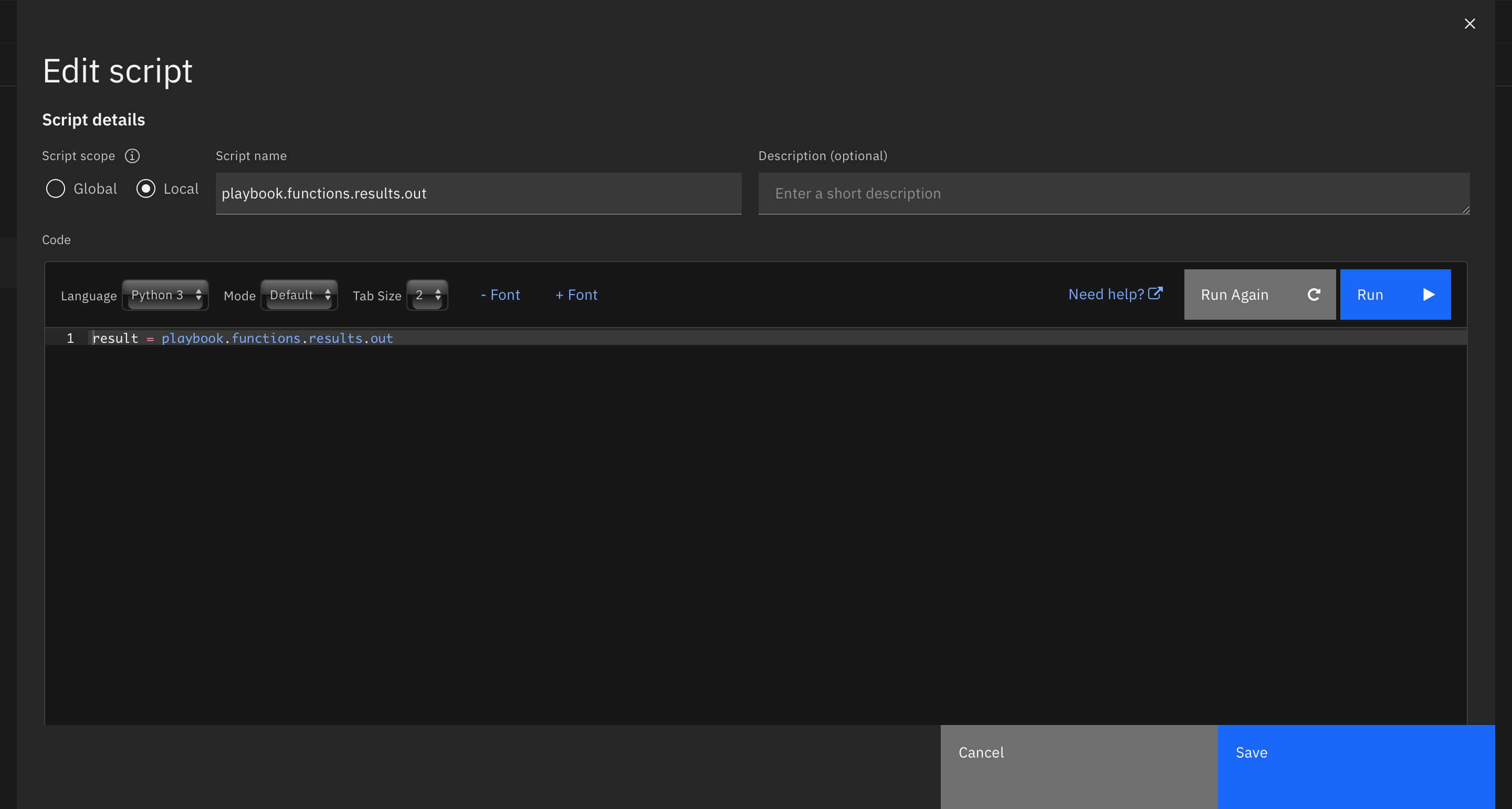

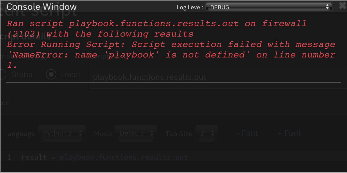

    Hello guys,
    I would like to print the results that i got from a previous QRadar Search function via a simple script. I am trying to access the results of the function by giving its output name; however, i keep on getting this error message. Any idea how to fix this?
    Thanks,
    Dany
    Script to access the results of the QRadar function
    Error Message

    Dany,
    The `playbook` object  will only be defined in scripts when the whole playbook runs.
    It looks like you may have ran the script with the 'Run' button when creating it?
    If you trigger the playbook then that script should work fine. Anytime you have a script that uses the playbook object you'll have to trigger the whole playbook to test it. You won't be able to use that run button. I'm hopeful there's a better solution than this that I don't know about.
    Hope this makes sense. Let us know if I'm wrong about my assumption with the run button.

    Posted 03/28/22 02:51 AM
    You are 100% correct. I have run the entire playbook and the script did run smoothly however, when i run it alone, it generates an error. Thank you so much
