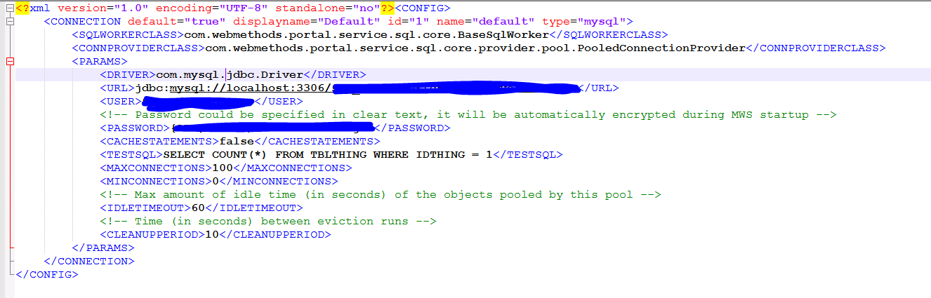

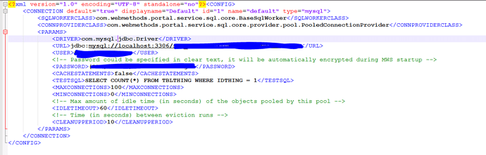

    2. Changed mws.db.xml in path \MWS\server\default\config in order to use com.mysql.jdbc.Driver (see attached file)
    3. Restarted My webMethods Server

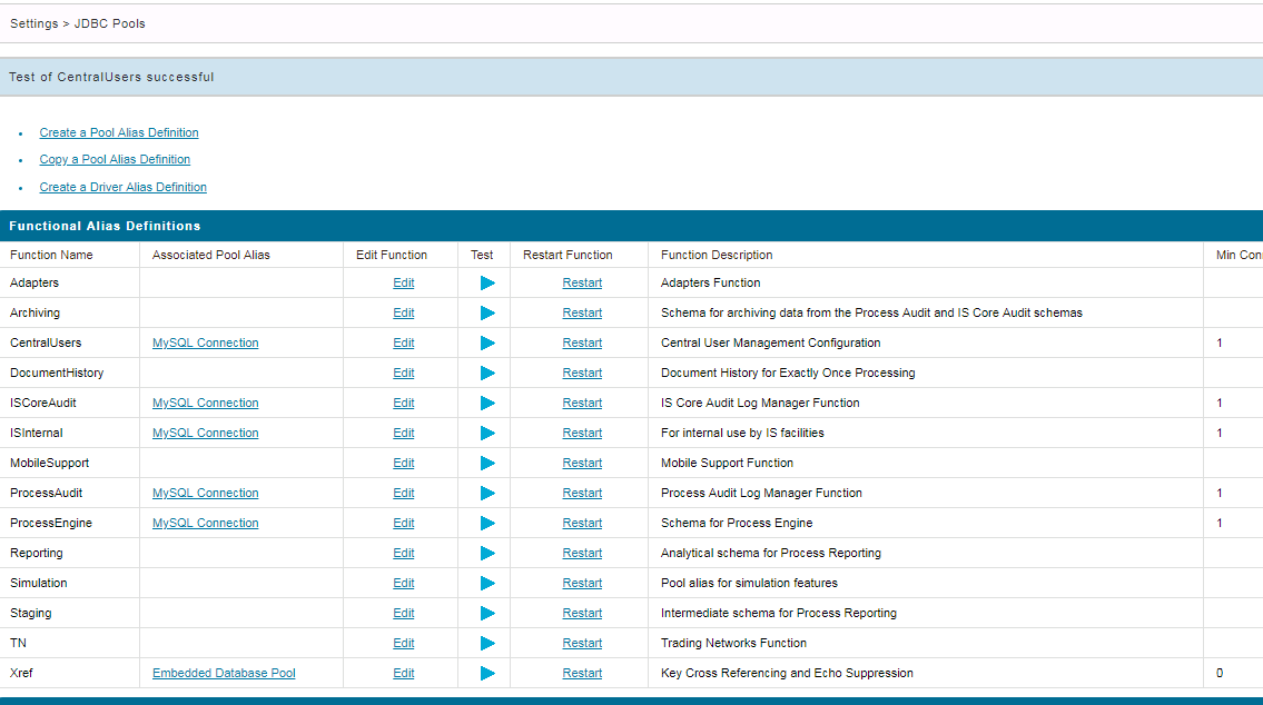

    After this. everything works fine in Integration Server. Test of connections is successful (see attached file). However, the My webMethods Server fails to start. The error in log file is as follows:

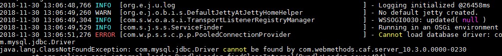

    <log4j:event logger=“com.webMethods.portal.service.sql.core.provider.pool.PooledConnectionProvider” timestamp=“1531386091234” level=“ERROR” thread=“Start Level: Equinox Container: e02fe91b-b285-0018-1328-aa56e1a696d0”>
    log4j:message</log4j:message>
    log4j:NDC</log4j:NDC>
    log4j:throwable</log4j:throwable>
    </log4j:event>
    Why cant My webMebMethods find the driver?
    Any idea why this is happening?
    Thanks a lot in advance :slight_smile:

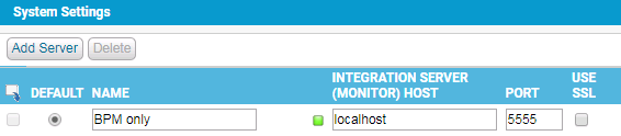

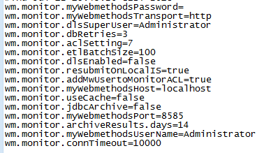

    I checked every config again
    • WmMonitor package is configured to point to the MWS
    • MWS SAML Resolver URL is configured to the SAML service of the MWS
    • MWS is configured to know about the IntegrationServer
    See also attached screenshots.
    I also checked error.log and MWS_full_.log and couldnt find any errors.
