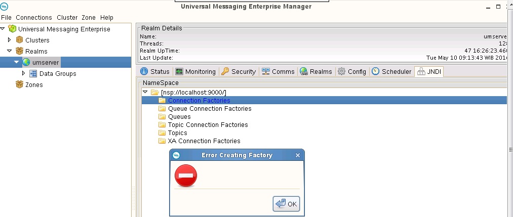

    Hi all,
    I can’t create a connection factory in my UM Enterprise Manager like this picture below.
    am I missing something? or there are another step should do.
    I have 9.9 version.
    Thank you.
