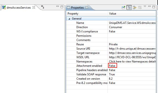

After some reading I found out that to use MTOM streaming you need to set the following property on the consumer in IS:
Attachment enabled: true.

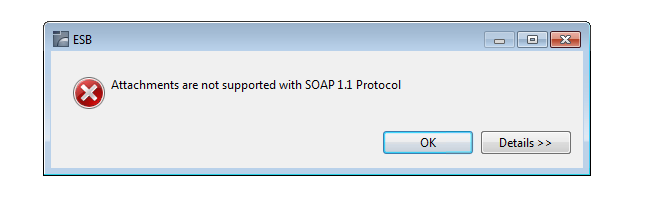

However when I try to set it, I get the following exception:
“Attachments are not supported with SOAP 1.1 Protocol”
I do not know what is the problem because usually MTOM works with SOAP 1.1 as well.
Did you had this problem before?
What should I do?
