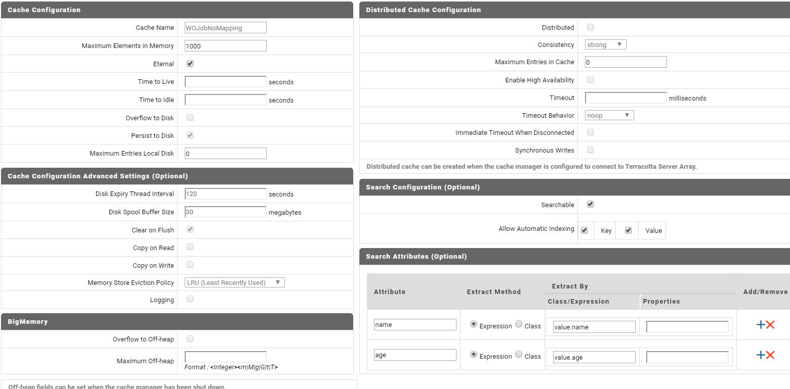

    Posted Thu February 27, 2020 02:10 AM
    Hi there,
    Trying to use pub.cache:search for the first time but without luck.
    I’d configured the cache to be searchable ( you can refer to the print screen)
    When tried with these search criteria:-
    1. OP1 = name
      OPR = eq
      OP2 =
    ERROR returned:-
    Could not run ‘searchCache’
    net.sf.ehcache.search.attribute.UnknownAttributeException: Search attribute referenced in Query.addCriteria unknown: name
    or
    1. OP1 = value.name
      OPR = eq
      OP2 =
    ERROR returned:-
    net.sf.ehcache.search.attribute.UnknownAttributeException: Search attribute referenced in Query.addCriteria unknown: value.name
    Any advice??
